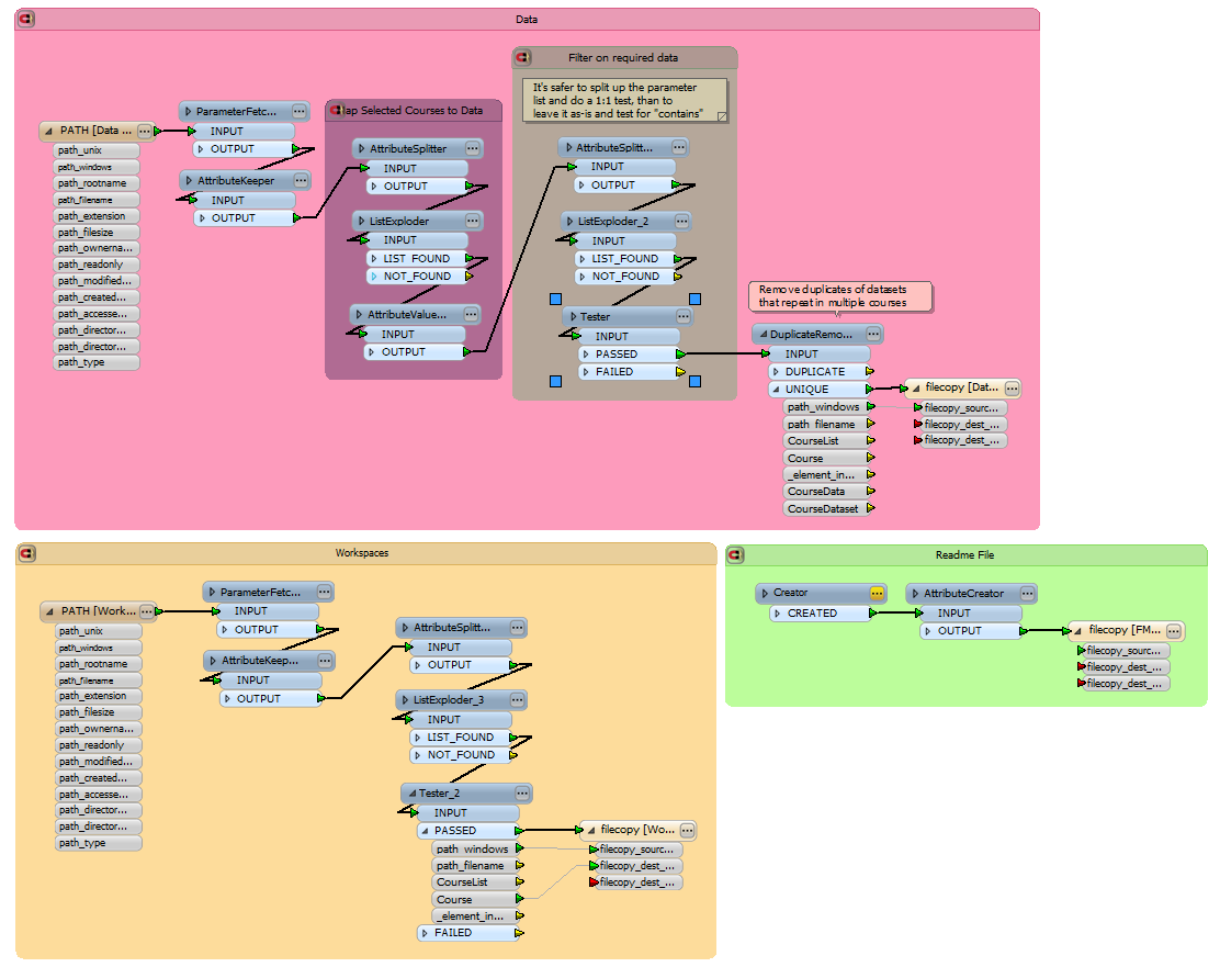

In fact the final workspace is a little more complex and looks like this (click to enlarge):
It’s more complex for a couple of reasons.
Firstly the content I wish to deliver includes not just data (the pink bookmark) but example workspaces (yellow bookmark) and a readme file (green bookmark).
Secondly, I want to be able to handle multiple courses at once. For example, I want a user to be able to choose both the KML and Esri courses.
To do this I end up using FME Lists. The selected courses are presented as a comma-separated string that I split up into a list and then explode into individual features. Then I match the list of datasets for each course as separate features. A DuplicateRemover transformer ensures I don’t try and deliver the same folder twice, even if it is used in both courses.
