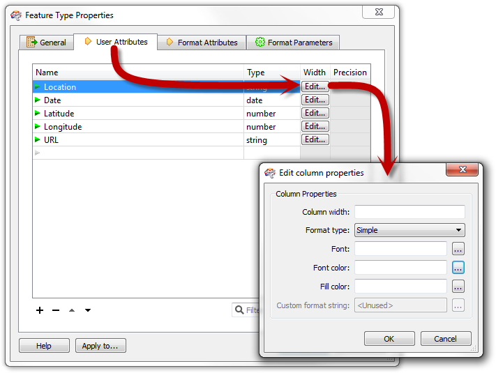

Notice how you access these – through the actual attribute definitions. I imagine we do it like this because you wouldn’t want to set format attributes for every individual feature/cell. In this dialog you can set the format of a cell to be simple (e.g. red font, yellow fill) or can be more complex by using a custom definition. For example this custom string:
[Green];[Red];[Magenta];[Blue]
…means colour positive numbers green, negative numbers red, zero is magenta, and strings are blue. The syntax for these strings is defined by Excel (it’s not an FME construction) and you can find more information in the Excel Help system.
